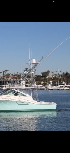

We have an FA50 AIS system that was newly installed. Initially we had issues with transmission. We replaced antennae and now are able to transmit. However, we have noticed a few things on local islands trips we will stop transmitting which can be fixed by turning power on and off. In slip we will sometimes transmit every few min but sometimes it’s over an hour. Looking at all the other boats they seem to transmit more regularly every 1-8 min or so.
Any ideas of where to start? We have our installers looking into it but it’s been a slow troubleshooting process so far with no solution. Maybe a connection issue somewhere?
