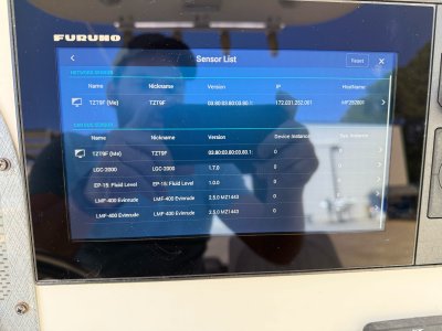

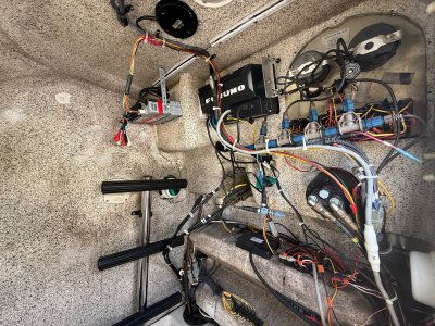

I have a TZT9F and a 2007 Evinrude 250 that are both connected to my nmea 2000 network. My engine broadcasts mostly standard PGNs. I have two lowrance LMF-400 gauges that are picking up the engine data on the network. If I look in the device list in my TZT9F, I see my tank and LC200, which I assume is the engine. The engine gauges are showing no data, but the tank gauges are showing. In an etec forum, someone mentioned that the device needs to be "enabled", https://www.etecownersgroup.com/pos...uruno-9719045?highlight=furuno&pid=1303972663. I don't see anywhere in the device menus to enable the data. Is there an extra step I am missing?
