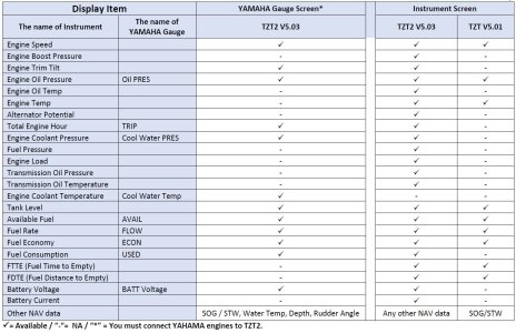

As far as I can tell I can only graphics (gauges) that can be displayed are RPM, coolant temp and oil PSI. Everything else is numeric/digital (see attached photo). I am able to set the range for the graphic/gauge data but I don't think the TZT2 allows me to configure alarm thresholds such as low oil PSI. I am not sure if the TZT2 will show J1939 engine diagnostic messages which would be essential to those who want to eliminate the OEM engine monitors.
I would like to see Furuno expand the graphics to include more gauges and to add alarm thresholds but otherwise am really happy with the setup. I don't know if engine diagnostics messages can be displayed, certainly something that would be important to eliminating expensive OEM displays and cleaning up the dash (maybe Furuno can comment on this).

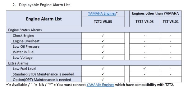

Hi Johnny Electron,
If I understand the chart correctly, it appears that the latest version has a much broader array of parameters that can be displayed (second column from the right)? Those listed are great and complete. The one request I would have for the next update is to display pre-alarms and alarms (Garmin will display a limited number). Doing so would make the (very) expensive engine OEM display redundant.

Thank you. If there's anyway to encourage Japan to broaden the list of alarms (and pre-alarms) please let us all know how. The incentive to avoid relying on the OEM displays (which are notoriously prone to failure and ridiculously expensive) is HUGE!
