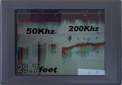

Gaps in the bottom usually means that bubbles are passing over the face of the transducer.
Below is a screen shot of what it can look like. One sign that I look for is that turbulence will (in most cases) affect the lower frequency first. If you can post a few screen shots that would help.
