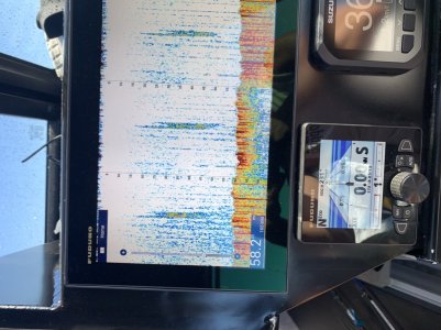

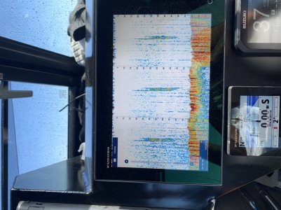

Hi guys, I’ve been running DFF3D for a couple of months now and have noticed that the port side display always is never as clear as the other 2. Is anybody able to recognise if this is interference with the transducer or a setting issue. The transducer I’m running is a 165T-50/200-TM260 DFF3D 50/200 Combination.

Strike j,
Thanks for posting the screen shots.
I can see you have a lot of turbulence from the streaks and broken bottom return.
What do the beams look like at the dock?
