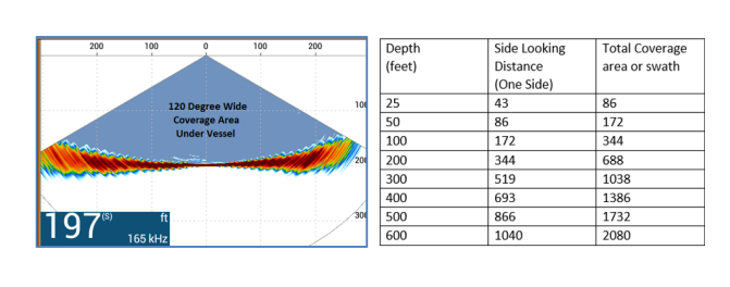

I got a PM that raised a good question. It appears as though the cross section mode shows the full 120 degree coverage of the sonar. Maybe the triple beam as well but Im not sure how to verify that like the cross section mode. The 3d history does not seem to show the full 120 degrees. 3d history shows approx a 1 to 1 ratio to each side. 100 ft of water shows 200ft of total bottom coverage. Could someone confirm and explain if this is just a technical limitation of that mode? And also the coverage of the triple beam. Thank you
