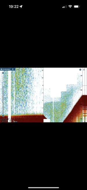

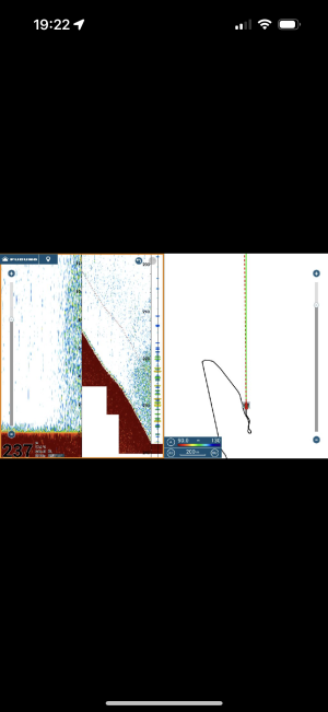

Thank you very much. I appreciate your answers. I was searching today with a low frequency and after 230 meters, I was getting always too much noise going until the bottom. When I was coming shallower than 230m the bottom was clear in the last 10-15m.
Do you have any clue why is this happening?
