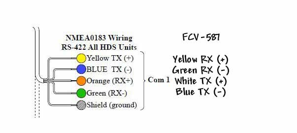

Hi, I have a fcv-587 and i want to connect with a lowrance hds 7 touch via nmea 0183. Is it possible? I want to save waypoint from furuno with a mark button to lowrance.

The FCV-587 uses a RS-422 format for it's NMEA 0183 in/out. If you set up the HDS 7 for this type of output you can use the below color code for the wiring.
