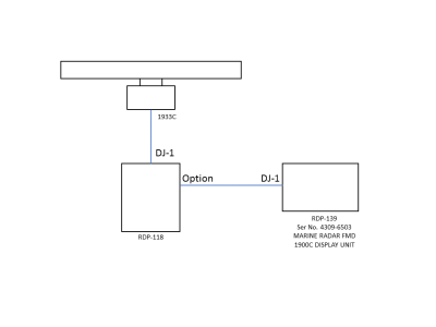

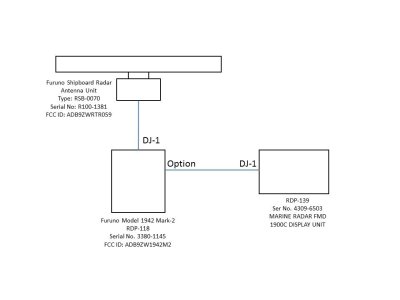

Thanks for the info. There is also another old green CRT unit associated with the old 1933C radar. It is labeled Furuno GaAs FET Front End 8-Tone Daylight Display. If I wanted to hang on to the 1933C for back-up, can the RPD139 run the old radar so I can get rid of the green CRT unit?
