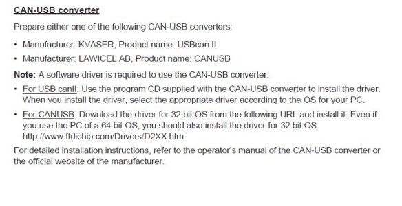

G GB119 Guest Sep 17, 2018 #1 Can I use any adapter to connect to the NMEA2000 network to use the SC33 setting software? Thanks
C-Bass Moderator Staff member Sep 18, 2018 #2 Good afternoon GB119, Thank you for you inquiry. Please see the list of devices below that we have tested to interface with the SC33 using the SC33 Software Tool. If you choose to try another device outside of the recommended devices below I cannot tell you if they will work or not. C-Bass
