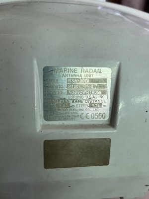

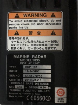

L linhkienbodam Furuno Super Fan Nov 13, 2022 #1 Hi, My Furuno 1944C display (RDP149) is damaged and I found a used Furuno 1835 display. Can RPD152 be used for my RSB-070-059 antenna? Thank you Attachments z3878967811891_1f94aeec0a4074477fdc55086963fa5f.jpg 148 KB · Views: 289 RDP-152.jpg 115.7 KB · Views: 289
Johnny Electron Administrator Staff member Nov 14, 2022 #2 Yes, you can setup the radar display as a 1942Mk2 that uses that same scanner model.
L linhkienbodam Furuno Super Fan Nov 14, 2022 #3 I got it and they worked very well. Thanks so much for your help
