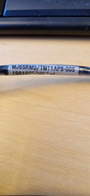

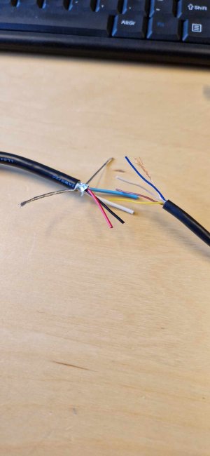

But I have another question for you all is it possible to connect ablue furuno cable 6 pins that comes from the network sounder direcly to the tz2 or to a NMEA 2000 network. I have got from Ebay some Furuno cabels and would like to merge this together. Is this possible or is there a cable that has the 10 pins to the TZ2 from the 6 pins and hopefull will this work.?
Thank you for all your replays :)
