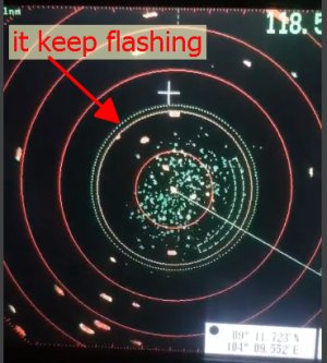

a alarm ring in my 1833C keep flashing. Is there any issue with it? How can I set it in normal. I took a video clip but I can not send it here because it is Mp4 file so I attach a sample picture FYR

Photo is cropped where you can see the full screen where some clues might be. Normally if an alarm goes off, you can hit the ALARM button to see what is the cause of the alarm. The Circle looks like you have setup one of your guard zones or have an VRM displayed. My guess is a guard zone and it is setting off the alarm as someone set it. Both functions are explained in detail in the manual.
