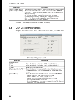

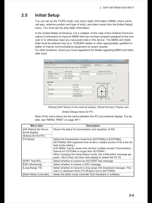

Recently installed a FA 70. I have two doubts regarding the initial installation trough the PC app.
What the use of on/off Long Range Tx broadcast?
View channel; when the region list pushed, I just have one line…what’s de porpoise of this function ?
