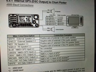

Ok so I now have a hub, cables for the units to the hub .Any idea what cable I will need for port one of the seven inch screen? And what color wires are + and- ais input ...also any idea witch wires are the output of the standard horizon 2200...? I looked at wire diagram but.....I think its yellow and white? And any particular settings on seven inch? I know I am asking a lot...I do appreciate this form and all the help I get.....

You need 7 pin data cable 000-154-028. It would go to data port one of the 7" unit. The AIS would be wired to the yellow (+) and green (-) input wires. This would connect to the Yellow (+) and White (-) AIS output from the radio.

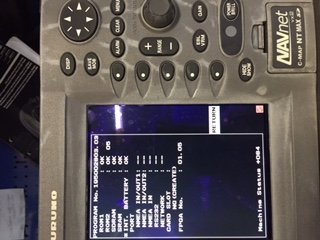

Ok so I have to update the rdp-148 unit I am installing on the network. It is updated to 3.03. and the serial number is 4327-1293 Can i get the update off this site and what display unit is it? Thanks again... I will eventually get all this together....
Jim
Sorry about being sideways but this is the unit..
Thanks,
Jim
