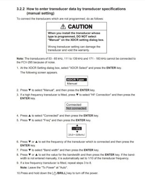

ELGATODOS,
You can find the information on how to "slew" the frequencies for the FCV295 in the Installation Manual. Also keep in mind that the frequencies between 53-65kHz, 111-139kHz, and 171-183kHz are "locked-out" to suppress any type of noise and interference.
I hope you'll find this information helpful..?
