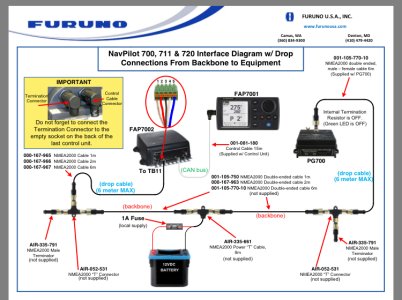

Below is an example of an N2K backbone.

As C-Bass mentioned, there are a number of different ways to wire the FAP7002. I've installed mine almost exactly as shown in the diagram above.
