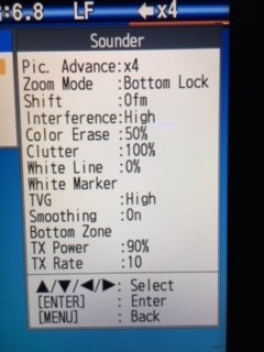

i'm not sure how to post the picture, see if that works. thanks appreciate it.
808fish,
Thank you for your settings.

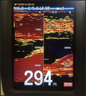

I think spending a little time at the dock using the Demo may benefit you. Here you can vary the screen advance, TVG, Clutter, Color erase and IR to see how each can affect the targets. Below are your settings vs the default.
