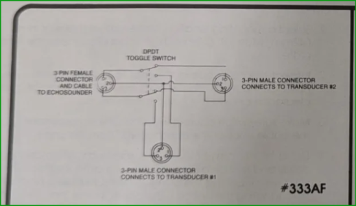

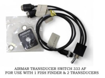

For the GP1971F, you can use either a "CW" 50/200 kHz Dual Frequency Transducer, or a Single Frequency Chirp: 40 to 225 kHz Transducer in 300 Watt, 600 Watt, or 1kW configurations. You must choose to use a CW or Chirp Transducer, but you cannot use both with the GP1971F.
