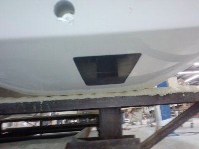

When keel mounting a thru hull transducer like a b25lh what is the max deadrise it can be mounted on?
I had a seacraft 23 that I had the installer mount a B265LH thru hull flush with the bottom of the boat and glassed in from the inside with no fairing block and it marked beautifully coupled with a DFF1-UHD and tzt-14 but I see everyone saying thru hulls like that need to be mounted with a fairing block. Is there a reason for that? And also I know my circumstance worked out but I'm having another boat built and I'm leaning on doing the combo 165T/265LH-PM488 for the DFF3D and UHD1. Can this transducer be mounted the same way thru hull with the face of it on the water and glassed in on the inside? The dead rise of the hull is roughly the same as the seacraft but it is in front of steps in the hull so mounting it forward of the steps is a must to prevent a bad reading. I have bunch more questions about my setup but this was the first thing on my list I had questions about.
Thanks
