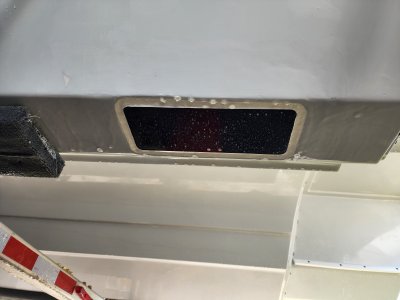

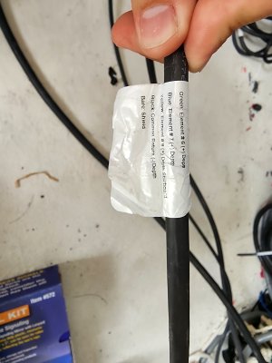

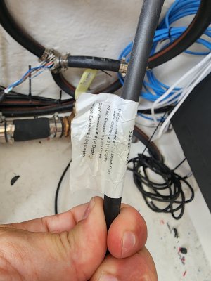

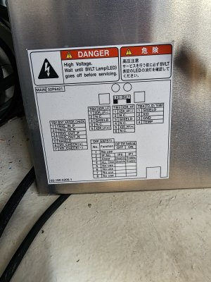

I am installing a 165T-PM542LM. It's already glassed into the hull and wired to the dff3d. But the dffuhd does not show any color codes to connect the other harness. I have looked in all the diagrams but can't find anything. Does anyone know where to find these diagrams? Thanks

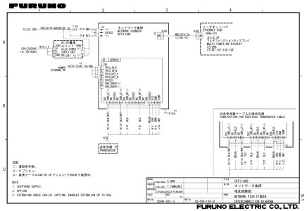

Not sure if you are talking about the DFF3-UHD, but if you are...the diagram is in the back of the installation manual, page S-1 (Interconnection Diagram).
