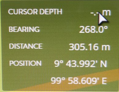

We have a WASSP F3 ( MULTIBEAM SONAR) unit and the "Cursor Depth" suddenly stop displaying and data - see screenshot of monitor
Mapping is still working - no depth data.
I have checked all the cables and made sure they are secure.
Not sure what I should do next.

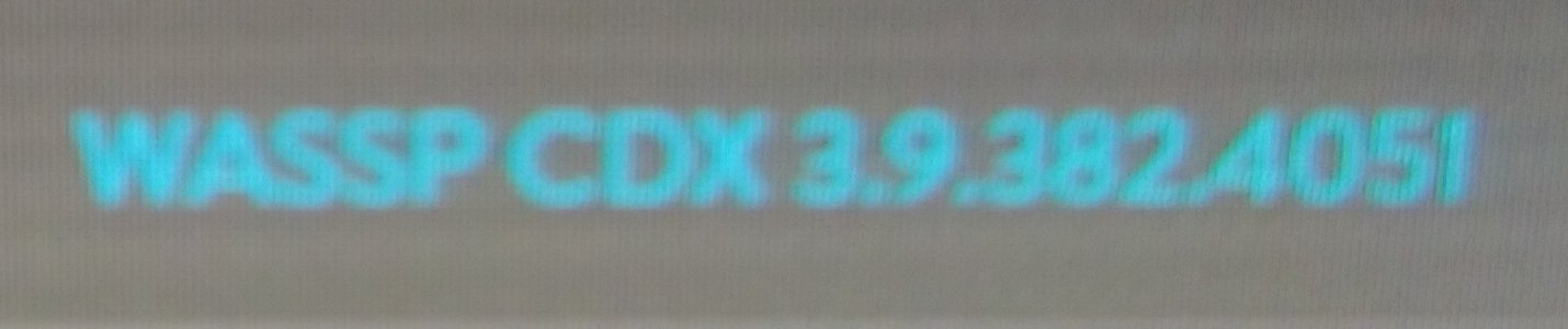

For this case I will try to work with you about your concerns. The photo you provided is quite zoomed so it is hard to see the full scope of the CDX software display. I loaded CDX 3.9.382.4051, the same as your vessel. When on the chart display my databox looks a little different than yours. In my data box on the chart display it does not have a place to show depth? I have made a quick video that explains this and also explains more about the depth at cursor. Please see link below.
https://drive.google.com/file/d/1YMwNrTnM24uGe47vL2Si6k_KUrhfdR3U/view?usp=sharing
Please confirm that when you place your cursor over an area that has previously been mapped that no depth at cursor is available, not in the data box but a depth number directly by the cursor like the video? Also if you could provide a larger scale photo of screen that would be helpful to know exactly what is happening.

2.) Try reloading CDX software version 3.9.382.4051
Your feedback is really appreciated, I will certainly reload the software and let you know what happens.
