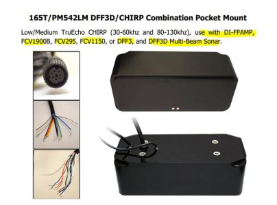

Is this package still valid and currently available? Specifically the combo pocket transducer. Finally got the funds to upgrade my electronics.
I was told by furuno tech support that the transducer above in the link is only compatible with the FCV1900 and would not work with the TZT3. has that changed?
I think you and the tech had some miscommunications. To use with the TZT3 you do need the DI box; maybe that is the misunderstanding. You can't directly connect to the TZT3, that would true but you can use the TZT3 sounder with the DI box and this transducer.
Here is a link to all the DFF3D combo transducers.
https://www.furunousa.com/-/media/sites ... _guide.pdf
The 165T-PM542LM page lists the suggested possible sounders.Capture.JPG959.JPG
