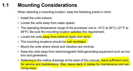

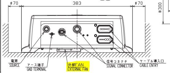

My old Navnet 3d BB was installed under a seat in the salon, sealed up with no outlets.
When out for a long day, it would freeze. Very dangerous when in fog and navigating by radar.
I installed a small computer fan (loud) and an outlet. Which cured the problem.
My question is will the new TZT2BB require the fan. It does not seem to have the same internal fan etc that the MFDBB did. How heat sensitive is the TZT2BB?
