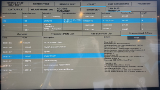

Dear all,
I couldn’t find any DTXXX device listed in the Sensor List, nor is it available in the Data Sources menu.
However, it’s strange that the DT200 is visible on the Service page and appears to be transmitting data normally.
