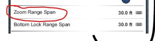

Based on what your explaining, I believe the Bottom Zoom feature is what your looking for.
You can set the zoom depth scale in the menu, see photo below. I you want to look at the 50ft off the bottom , then set the zoom to 50ft and turn on the bottom zoom.
Page 164, 165, 177 of 299 in the manual.
