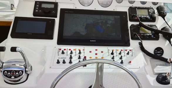

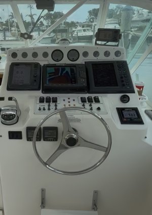

Thank you for the input. My problem is that on a 2002 dash I am pretty sure I could only fit one 16” centered unless I re-fabricated the dash. The boat is not local yet so I cannot try to fit templates. I do have all the measurements of the dash and do not think two 16s will work and I want two screens at heAlso budget is an issue, I don’t have unlimited funds. I’v attached dash pictures of my dash and or one I found on the web.

Check the dimensions -- a 13X is almost the same width as a 16X. I suspect you can fit two 16Xs. A friend of mine used to have a Cabo on which I fished many times and I recall he had two big Simrad displays side by side. But there is a cost issue, though in context it's probably about the same as what fuel costs you for one or two runs out to the canyons and back.
