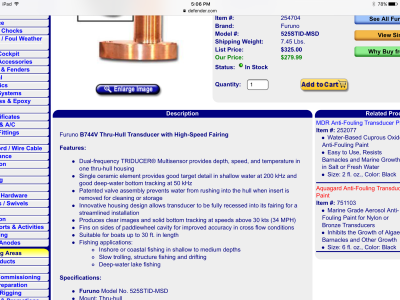

It was noted on the Defender website. See attached. I initially said Furono docs but I may have been thinking the Defender website. PErhaps it is a typo on the Defender website.

Sdpaddler50,
Thanks for posting that. I would have thought they would have used the same bullet points that are on Airmar's spec sheet.
