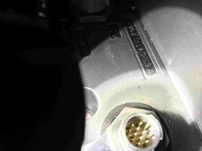

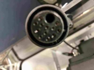

What is the other 12 pin connector go to normally? If that is an Airmar 12 pin mix and match, you would need see if they have a 12 to 12 pin adaptor. That 12 pin is obviously not the 12 pin Furuno connection or anything we sell.
Checked with Airmar and they do offer a MMC-12F. Thanks for sending me in the right direction.
