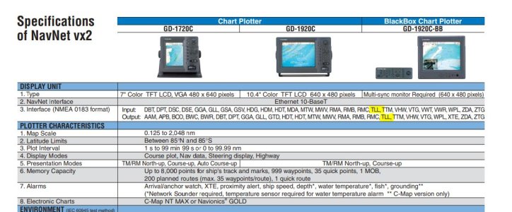

Thanks Johnny. I perhaps didnt make myself clear? I have a 588 sounder that I am very happy with. I have a Raymarine e7 that I am using as an MFD to display engine data etc but I have also managed to successfully provide GPS data to sounder via a network so that I can at least capture wpts on the 588 using the mark feature. Unfortunately I have a Navman 8120 as my primary plotter that I am very happy with but it doesn’t accept any wpt input (of any sort) so I cannot get my ‘marked’ wpts showing on my plotter. I have been investigating Furuno plotter options (of a similar size to the Navman 8120 about 10 - 12inch) to see if I could get this function to work. I had investigated a Furuno RD-149 Vx2 (see my other post) but am told this will not accept TLL wpts from an external source. I know the GP-39 does but it is not a chart plotter and is too small a screen for what I am wanting to do. So my question was what were my options to replace the Navman. I was provided with the answers above (helpful) but my comment was more about there seeming to be limited opportunities to use the mark feature on a Furuno sounder to plot captured wpts on a plotter and for the ones that can...you may also need to have an added adapter / added cost. It just seems a little weird to me.
Someone told you wrong. If you have newer software the Vx2 supports both TLL In/out.
Don't confuse external waypoint (which Vx2 can also do) with TLL (Target Lat/Lon). If your goal is to have the FCV588 send over a TLL and it show up on the Vx2; there should be no problem. Of course the Vx2 is no longer sold so you will be shopping in the used market.
