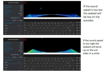

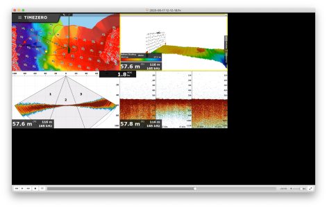

Typically when you see the edges of the swath bend up (like a smiley face) or bend down (like a frown) that is an effect from the sound velocity of water. Below is an example from some WASSP Multibeam Documentation.

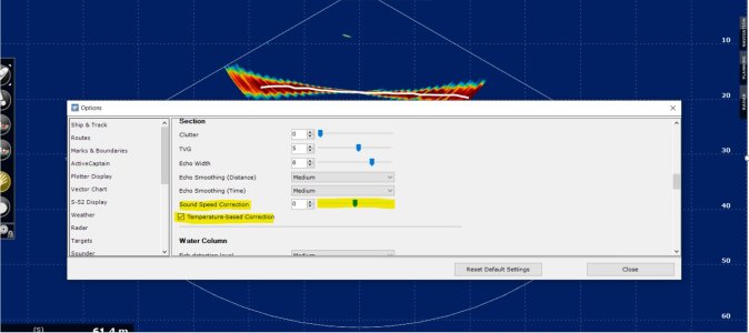

There is a setting to adjust the sound velocity in TZ Pro, even though the DFF3D uses Sea Surface Temp to compensate for water temperature sometimes it does not provide all the correction needed to make sure the full swath has the right sound velocity timing. But it is pretty easy to correct manually. Make sure you are over a flat bottom, then go to a full screen section view. Next open up the TZ Pro Options Menu and choose Multibeam. When that Options window pops up, pull it over to the screen and put the top edge just below the white bottom line in the section view. You can use the Options window like a straight edge. Next, scroll down in the Multibeam Window until you see Sound Speed Correction, first make sure the Temp Based Correction is checked. Next, move the slider for the sound speed correction, until you see the edges of the swath (White Line) get as straight as possible. When you are over a flat bottom, the distance between your straight edge (options window) and the white line should be the same distance all the way across the screen.
I provided a photo below, although the bottom in the demo file is not straight, it is angled but it shows you the concept :).

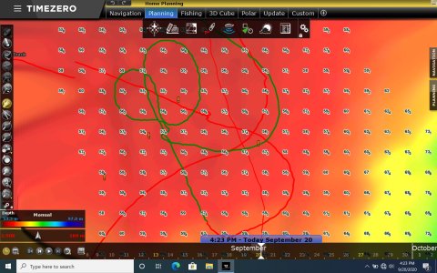

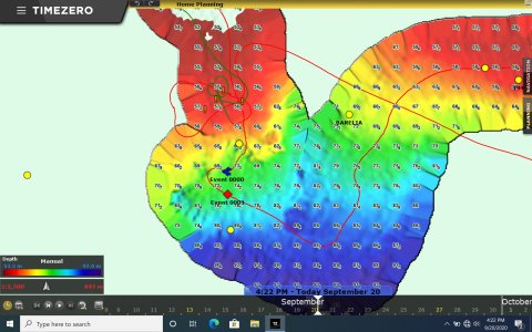

For example here is a nice small reef- rock, which it always has a lot of life on it, unfortunately, it is not showing on the PBG, I have a lot of such examples.
I showed this stuff to Maxsea but they say, PBG is not for such details, it doesn't need to be upgraded.

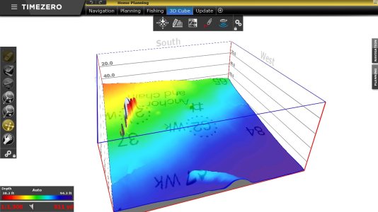

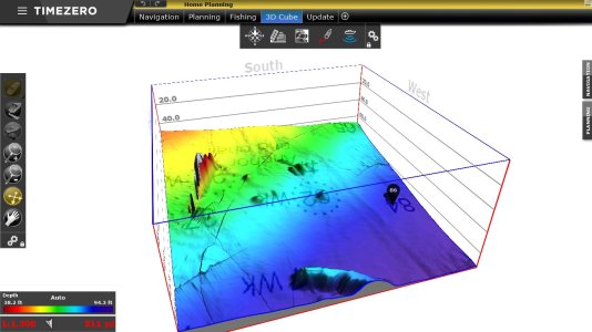

Try turning your Terrain shading up. Below is one at 0% and another at 100%.

Maybe change the range on the pallet as well? 40m colour ramp on a small rock will never show much. Your mark seems to be in a 10-20m depth range?

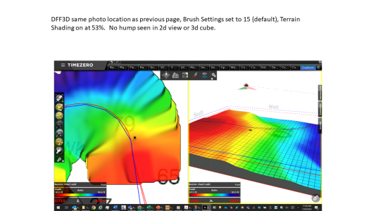

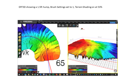

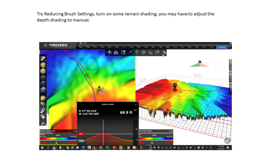

I have replayed some data showing what brush settings can do to small elevation changes in TZ Pro. Brush settings should be reduced to a small value to get better resolution on small elevation changes. Slide1.PNG
