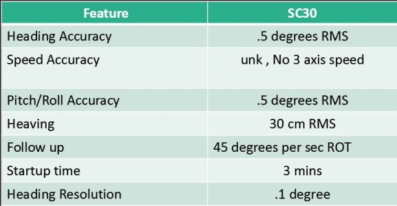

Do you happen to know what the accuracy for the SC30's roll/pitch measurement was supposed to be?
Matt
