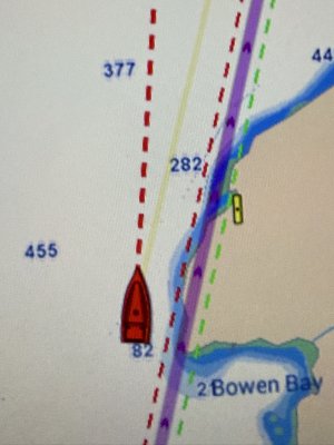

I have a bunch of lines all over my plotter. How do I turn off the red and green XTE lines?

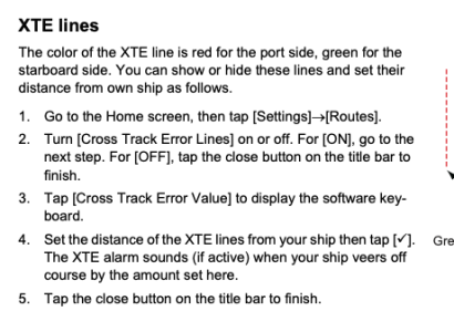

Found my answer in the TZT3 manual.
