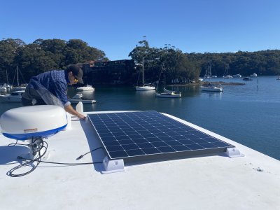

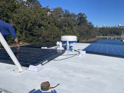

The DRS4W is mounted on a 10' Scanstrut on the flybridge hard top. (We removed a 6' Furuno antenna array system so as to install solar panels. The DRS4W dome was the right size.
The DRS4W radome is at least 12" above the solar panels.
You will see a 1.5" sloping mast head light mount to the rear of the solar panel.
Any comments? Photos were taken during a test installation of everything.
The radar energy might not be good for the solar panels. I have seen a similar install where the panels reflected energy back at the radar completely stopping the auto modes to work properly. The radar is back way too far on the top. The RF energy is digging down into the boat top instead of the water in front of the boat. If it works well there, I would still be a little concerned as the panels get hit by the radar energy. The masthead light structure isn't seen well but you might need to put in a sector blank zone for that area so you don't reflect RF off it. You can't see through masts and objects anyways so no use bouncing RF off it. I am starting to see why you only get 2 miles of returns. I would highly recommend relocation of the radar.
