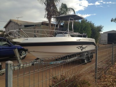

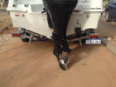

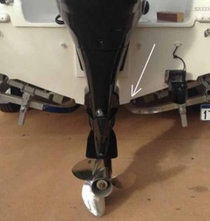

have entered a couple of pictures i gather i should install transducer closer to the keel

What you are experiencing is pretty typical of a transom mounted transducer. The sounder works well at the dock and as the speed picks up the performance starts to degrade. Also turning the vessel will increase or decrease performance depending on the direction of the turn. So what to do? That first strake where the arrow is pointing is going to cause water flow issues for anything mounted outboard. You can try adjusting the tilt and the depth of the transducer in it's current location and you may gain a little better performance. In looking at the pictures you provided (thank you for those) it appears that your smoothest water flow will be within that 18" center area. That being said, is it feasible to mount the transducer in that location without it interfering with your outboard. Hard to tell without seeing more detailed side views of your current setup.

if i installed the transducer near the arrow before the chine do you think this would work

Pictures would be nice. A stern shot and one from the side that shows the depth of the transducer in relation to the prop.
