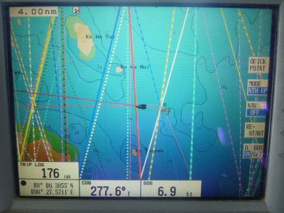

I have a RDP149 networked plotter on Navnet2. It worked well until I moved the chart offset on source unit (which is the Radar and where the map card is fitted) to align with the radar image - there are significant chart/GPS errors in this area. I later removed the offset
The screen on the netwroked display now goes crazy when it is switched to plotter. It works perfectly on all other displays. I suspected a network /hub problem but switching hubs etc does not improve

A picture of the plotter screen is attached

Strange lines might be chart data related, tracking lines etc.. Suggest you try using the units without a chart card and see if the lines are there or not.

The networked RDP-149 unit is fine for radar or sounder etc. No lines or other interference. It is only on plotter. I will try moving the SD card into that unit and running plotter from its internal map reader rather than over the network. My initia reaction was that it was a hub or network problem but other displays are OKl.

The photo you have reminds me a lot of lines made with the marks and lines feature. If still having issues with that display, you might try clearing your marks and lines and see if they go away.
