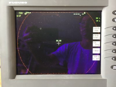

This means your radar source setting is not correct for where the radar is connected. For example if the host name of your unit is "PLOTTER" and the radar is connected to this same unit; your radar source should also be named "PLOTTER". If the radar is connect to another display on the network, then that display must be turned on and the setup should match the name of that unit for which it is physically connected to.
