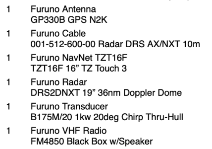

Tell us what items you have on your invoice.

Looking at your equipment list, the installer did you a disservice in my opinion using a GP330B. The TZT3 internal GPS is just as good or better so you didn't need it. Better to have spent that money towards an SCX-20.
