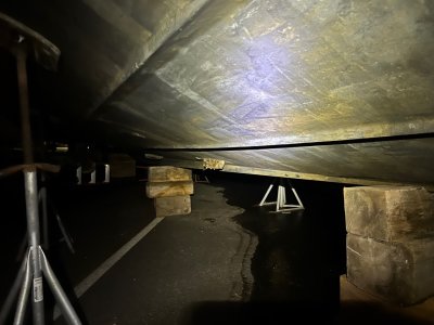

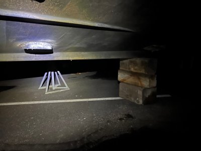

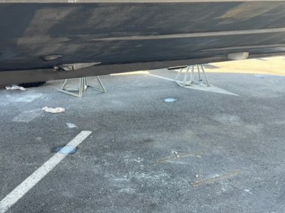

Is there a work around for larger boats. I have a 40' Cabo. I don't think I have a spot for 180* single transducer.
Here is what I have.
Options for a single would be thru middle of keel... yikes
Or just to one side and build way down... yikes again.
I think the first idea with a fiberglass guy would be best. I need to keep back as far as possible due to Marina trailer set up.
Or just wait for the pairs. I have two fairings now, hate to add two more.
The bottom of my 37' express looks almost identical to that. On this boat I have relegated to waiting on the pair with fairing blocks and doing it correctly. On my 46' sportfish it has a perfect V all the way to the keel. This boat I will be putting a single thru hull in on the keel with some re-inforced glasswork to build the transducer into the center of the V. This work will be happening right after the bluefin season closes in NC.
Thanks Gstang, Next I am going to measure the width of my small keel. If its >= 2". I may try to install there and build up fiberglass if needed, back enough not to be hit with the trailer cross members for launch and haul.
Keel is 2.25" I am going to ask my marina guys to see how far the cross beam on the trailer comes back. If it's ok I will cut out a slot to mount the transducer in the keel. I am thinking one would be much better than two. No fairing needed and only one more hole in hull. At this point I will be running 4 transducers...yikes.

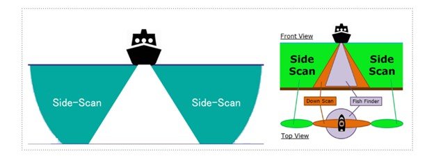

This is the coverage that the 230kHz CHIRP Side-Scan Transducer is going to provide you:
I hope this information is helpful..? :think
- Deep Blue
Great Thank you.
That's perfect full 180* coverage out to 700-ish yards.

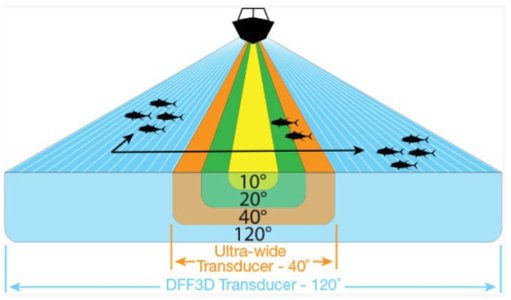

So the "Down Scan" is my 3D transducer?
sdonx,
Yes you are correct. This is an example of the coverage that is provided with the DFF3D's Down Scan:
- Deep Blue

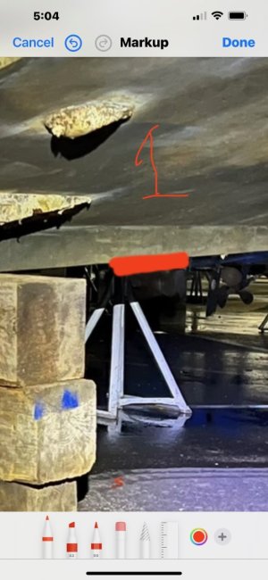

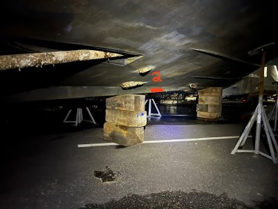

Deep Blue, I am debating mounting two different ways.
#1 out the bottom of the keel fully exposed (more susceptible to damage) possible cleaner waterflow?
#2 recessed into the keel (protected) would this cause more bubbling?, as I need to keep the sides exposed 180*? Not sure how smooth it would be too.

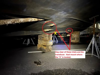

Because you have other transducers on both sides of your vessel, including engine inlets, this is where I would recommend placing the Side-Scan Transducer:
sodox,
Hey, that's a great location..! Once you splash the boat, if you would please provide some good pictures of the side-scan in action..?
