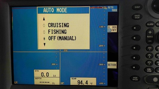

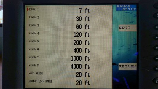

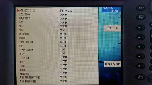

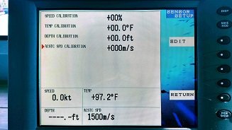

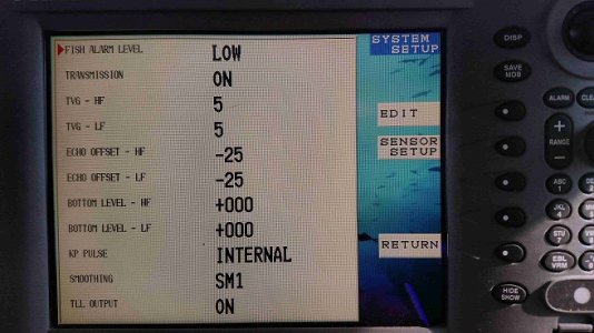

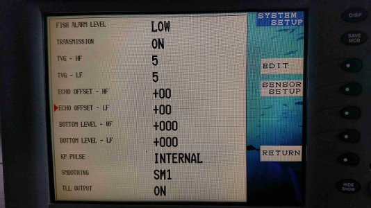

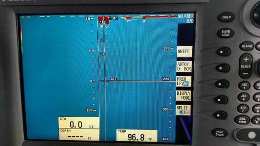

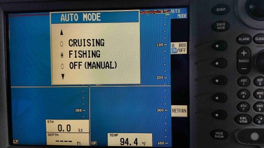

I have no reading for depth on sounder or any other screen. Checked settings and they are correct. I have temp and speed from transducer but no depth. When I spin the wheel it registers. This is a new transducer and black box sounder. Settings are ETR NOT NMEA. These are when I am sitting out of water. There is 3 ft of clearance between transducer and ground. It should register something. Only _ _ _. Any ideas?
If you are showing a good bottom on the sounder, then it sounds like you need to adjust your bottom level adjustment for both HF and LF. I would recommend -20. If you don't have a good bottom showing on the sounder, you must fix that first.

Please post a screen of the unit showing bottom depth on the sounder screen. For the two screens showing the sounder, neither have a depth bottom showing. You will never get digital depth to show up until you have a good sounder bottom.
The only time it ever shows on the screen a depth is when switching to the sounder display. It flashes 0.0. It does not stay. Only a flash of it.
How do I set it for a good sounder bottom, out of water with 3 foot clearance.
