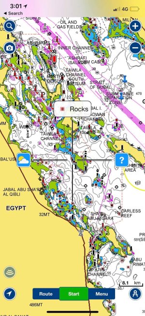

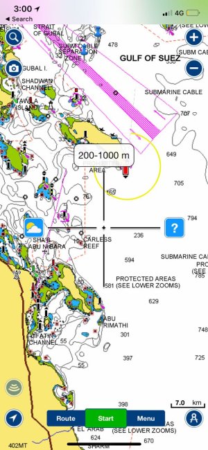

i add some screen shots for what is the area i will be fishing looks like we do all kind of fishing in the redsea jigging in 30m to 220m depth -bottom fishing 15m to 250m depth- popping and casting beside the reefs - trolling and deep fishing for sword fish and big squid you can say we fish from 15m to 500m .
