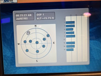

I leave in about 3 weeks for a 5 month cruise. My NN3D gets GPS from two data sources -- unfortunately, both are Furuno. I have a GP-32 as a backup, and a GP-330B as primary. Both are broken. I have limited time to get this fixed, and I use the tide features daily when anchoring in northern ports with 20+ foot tides.
Are there any solutions other than a new receiver (actually, two for north of $1K plus labor)? Since accuracy of date and time isn't terribly critical (plus or minus several minutes is just fine), is it possible to turn off the "use date from GPS" in the setup wizard data sources and then manually enter the date and time? Sort of like your phone still knows the date/time when out of cell service? Or will it automatically use the GPS every time it comes on line?
