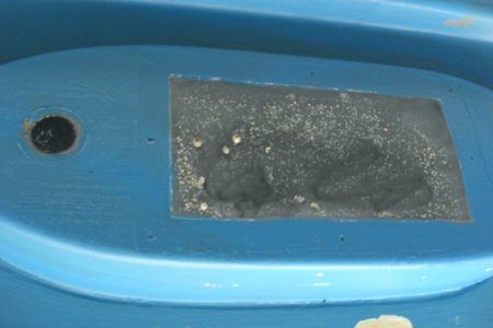

We (FUSA) get involved more with placing transducers more than advising how to mount them. We will leave the mounting up to the individual dealers or the vessel manufactures. However their are two commonly used methods. First is that the transducer is mounted in a fairing block and then the fairing block is attached to the hull. The second is that the transducer is attached to a removable plate and then fitting up into the fairing block. Below is a picture of the latter, if you look closely you can see the screws holding the plate in the fairing.
Hi Snips Thanks for the prompt reply; especially on a weekend. It sounds like the transducer must be surrounded by fluid for cooling? If so, what distance between the transducer & the walls of a housing must be maintained? It sounds like building a water tight pocket inside the boat with the transducer face flush with the hull exterior is good?
Ericl,
The cooling of the 488 is done via the face of the transducer not by the sides.
