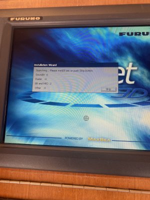

Is your network switch operational? If it is, then launch the Installation Wizard, do not hit skip, and see if the sensors reappear. It might just need to rebuild the configuration file.

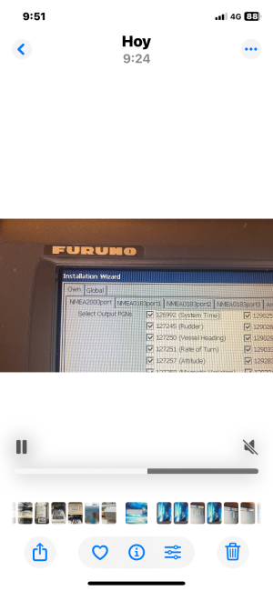

asistente de configuración me sale el radio de la sonda, pero luego desaparecen ya luego lo que me comentas, y si tengo MFD el 8y el 12 , yel 12 es el máster, y la versión que tengo en la 2.13
Yes, I did everything you told me in the configuration wizard, the probe radius appears, but then what you told me disappears, and if I have MFD 8 and 12, and 12 is the master, and the version I have is 2.13

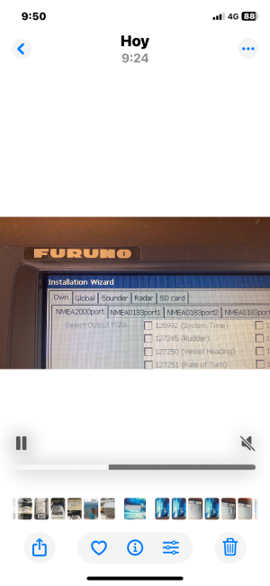

When I am in the configuration wizard in the bar above, if you see the probe and the radar that are in stand-by until I start entering MA 2000, port 1, port 2, and then they disappear
