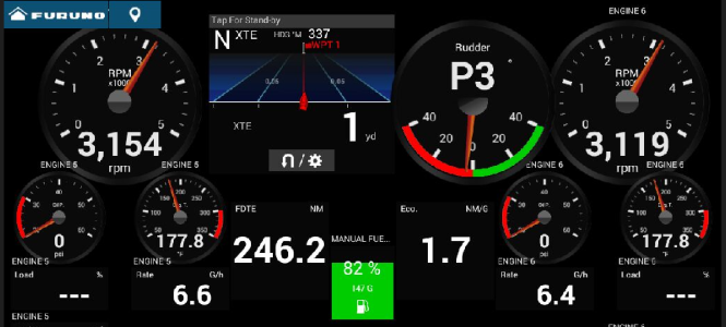

I recently added 2 Yacht Devices J1708 Engine Gateways to my boat to get engine data (Volvo D3) to the TZT3. Setting up the instruments page was very intuitive and love the functionality. Question, in the screenshot below the engines are shown as Eng 5 and Eng 6. Twice that has switched to Eng 7 and Eng 8 and obviously there is no data. Is this an issue on the Tzt or Yacht Devices side?
