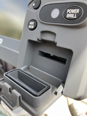

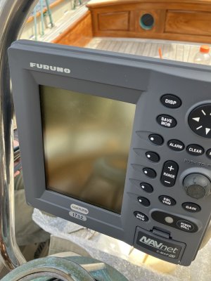

I need east coast card for this unit. Is there a way to get that? My friends bought this to replace their old unit. Thought they could use their old card. However theirs was an SD card. This takes a bigger one. This unit was bought on eBay. IMG_0017.jpegIMG_0018.jpeg
That looks like a vx1 if that’s the case. C-MAP no longer makes those cards.. take a pic of the sn number on the back of the unit one of the furuno guys can look it up for you to confirm what it is. If it’s a vx1 you could look on eBay or one of the used markets like max marine. To see if they have any cards..
That is a NAVnet1 and @Locrasto is correct...there are no more new chart cards sold for that unit. If you want to buy a used one, I'd recommend verifying what software is in it to see which type of card you need. Press Menu-System Configuration-System Setup-Test & Clear-Memory I/O Test-Display Unit Test and provide the full program number here.
I would almost guess that this unit is older than the one he replaced. The NN1 released in 2001/2002. Any mapping would be from the used market and older maps.
