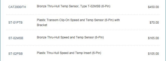

Below are the four most common options for getting temperature into the FCV-1100.
