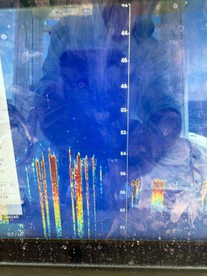

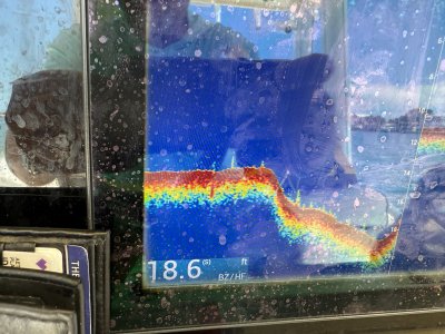

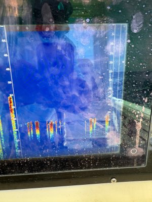

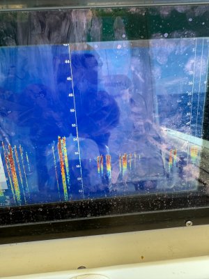

We run dual TZ2t's on network with two transducers wired to Dff-1.
B175C20-HW 150kHz to 250kHz 20 degree 1KW and a
B175C-20-L 40 kHZ to 60kHz, 20 Degree ,1KW,

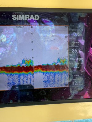

Picture is good when we first turn unit on and we are in Shallow water. Once we start running offshore in deeper water the picture is terrible. Seems to be on a problem on both frequencies, the high or low transducer. Is this a problem with the DFF1-UHD not supplying power or something else? Can i send the DFF-1UHD in to furuno to be checked? Here is picture of the simrad we also run for backup on different frequencies and pic is excellent
Very disappointed and about to pull all this furuno out....
fyi- Nothing has changed in either system other past 4 years other than the display quality oif the Furuno??
is this while at speed > also is the UHD New my understanding is the UHD is for chirp transducers mostly but i had this but on my Simrad Nssevo3 running the 5100 module and it was my transducer angle was wrong so it wasn't seeing the bottom . i adjusted the angle and then was fine . id have a look on youtube at Dff1 setups and settings , it could be something simple
