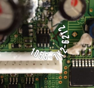

HI,
wonder if anyone know that this part are, this belong to fcv620 fish scanner power input
my one are burn out but doesnt hav a clue of what it replacement should be

There are many versions of the 1055 IC. The schematics that I have doesn't show it but it's location suggests it may be associated with the LCD backlighting circuitry. Let me do a little more digging to see what I can find.

# this 1055 8pin is not locate at the lcd part circuit, it is locate in the power plug and it is the first ic that receive 12volt power supply.
see picture
Moon,
Good news, the 1055 has a PN of 000-156-131 and have them in stock.

With that part number you should be able to order the IC from any Furuno USA dealer. They won't have one sitting on their shelf but they can order one from our Camas office.

I have the same problem in my FCV585 motheboard.
I have two FCV 585 but the same integrated is marked one time 1055-7K2-62T2 and in the another identical tool 1055-OC3_JL.
could you tell me which one PN I should buy to replace the “1055-7k2-62T2”?
Thank you very much
