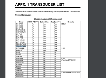

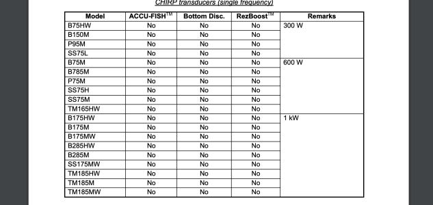

We currently run dual TZ2t's on network with two transducers wired to DffUHD-1.
B175C20-HW 150kHz to 250kHz 20 degree 1KW and a
B175C-20-L 40 kHZ to 60kHz, 20 Degree ,1KW,
Want to add unit on second station. Only have 13"X8" of space on the console to work with.
Can we add a TZtouch TZT-9 without changing any transducers? i have access to excellent condition one.
or
Can we add a TZtouch3 9" MFD?
or go broke and add a TZT10X - 10" TZTX?
What would be the advantages? Disadvantages?
I will probably be upgrading the touch2's next year....maybe
thanks for your suggestions!
